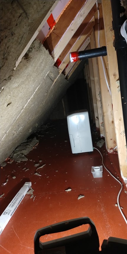

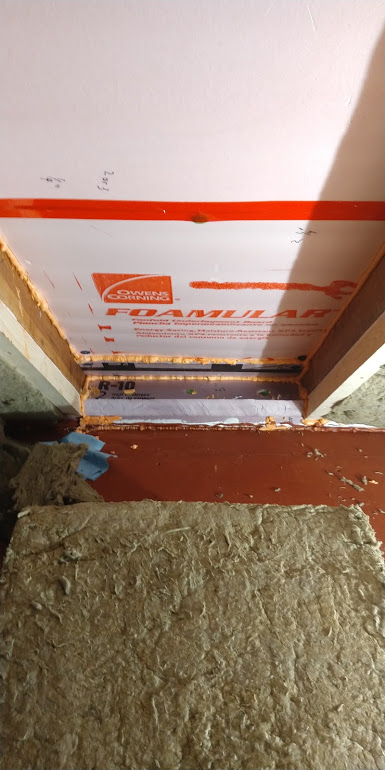

我在GBA和其他贸易和建筑网站上看了几篇文章,仍然很担心如何解决我的问题。我有一栋经典的威斯康星州1-1/2层的房子,建于1980年,有拱形天花板(12/12英尺高)和膝墙。椽是2×6 24″在中心与椽领领带appox。10 '长,创造了一个8 '高的房间,5 '斜墙和一个可访问的上层阁楼。瓦片屋顶是最近才更换的。2层斜墙、膝墙和上层阁楼的所有旧玻璃纤维绝缘材料都被拆除了,只有教堂客厅的绝缘材料无法使用。下面的椽和椽领是2″EPS白色泡沫和5/8″干墙。石膏板和泡沫在良好的条件下,我不打算改变或删除任何现有的完成。所以我的部分完成的计划是空气密封所有的天花板,电气,管道石膏板密封,壁板等在天花板平面和膝墙阁楼。我知道我不能达到R50在2×6斜墙椽和添加顶部屋顶护套不是一个新屋顶的选项,所以我能做的最好的已经足够好。 In the 2×6″ cavity slant wall I installed 1/2″ XPS on top the existing 2″ EPS and then 3-1/2″ R15 rockwool leaving approx 1-1/”2 air space between the rockwool and roof sheathing. The soffit has continuous vents as does the attic ridge. The rafters in the knee wall will now become the thermal envelope and be as follows -roof sheathing-2″ airspace- 1/4″ dow XPS or 3/4″ EPS foam field built vent channel(sealed to joists) -rockwool R23 (2×6″ rafter extension to accommodate the insulation). – and lastly 1″ polyiso foam sealed and taped joints. The upper attic will be R23 rockwool between the collar ties and either r30 fiberglass rolls perpendicular or cellulose blown on top. I also insulated the rim joist in the knee wall with sealed 2″ XPS and R50 rockwool, painted and sealed the 3/4″ plywood floor in the knee wall. I understand this isn’t perfect but as good as possible with what I can DIY and not break the bank. Everything has been going good until this week. The rim joist and floor of the knee wall is completed and as I was installing the R25 in the knee wall rafters the weather turned bad. The last week the temp in the 20’s and 30’s with very high exterior humidity and will remain this way for the next week. The indoor temp is 64 with 73% high humidity. Condensation is already showing up on the 1/4″ XPS rafter air vent channel and the 3/4″ EPS rafter vent channel above the rockwool before I can get the 1″ ISO foamboard up. NOW WHAT??? do I have to remove the rockwool and dry it out or replace it? Should I poke holes in the site build sealed vent channels to allow the rockwool to dry into the vent channel space? Should I do something different in the knee wall rafters? Sorry for the long rant but The more info maybe the better understanding.

    泡沫排气通道对于R23或R15岩棉来说并不是必需的。在安装电池和其他层之前,在薄泡沫通道上形成可见的冷凝是因为它们比空间空气的露点更冷,在与空气接触时,这种情况不会在内部箔面泡沫安装后发生。
    如果通道泡沫是较胖的泡沫,内部面对表面可能保持足够温暖,看不到可见的冷凝,但这是没有什么需要担心的,只要最终的内部箔面polyiso层是气密的。即使通风口挡板泡沫是箔或塑料面和水蒸汽密封,当有连续的空气和蒸汽屏障(带箔面多面体)在内部一侧时,通过椽的干燥路径是足够的。

    谢谢你的回复,很抱歉在措辞上这么拖沓。所以我将离开安装,除了我可能在排气通道切割孔,以加快任何干燥到有点潮湿的岩棉的排气通道。
    你认为我需要擦去排气通道上的冷凝物,并烘干有点潮湿的岩棉在我安装polyiso之前?或者当天气变化,干燥一点的时候,它会足够干燥吗?现在我在膝盖的地方开了一台35%的除湿机来保持干燥。整天开着加湿器,在那个区域只能除去大约一品脱的水。

      在短期内给房间加热可能比开除湿机更有效,但两者都要做。
      从干燥的、未安装的岩棉开始,在岩棉安装的同一天安装并密封内部多面胶。如果岩棉安装好了,一个星期后,polyiso就会在岩棉较冷的一面形成大量的水分。如果它在同一天上升,就不会有太多滞留的水分。

    如果容易的话,我会擦掉凝结的水。我的想法是,一开始不要在建筑组件内部产生任何额外的水分。从尽可能干燥的组装开始,以减少未来可能出现的任何问题。

    因为你在WI,如果你在隔热和蒸汽缓速器完成之前开始加热一个空间,在一年的这个时候或之后,事情将会结霜。它会自己干的。隔热,降低室内湿度,把你的蒸汽缓凝层封起来,然后给建筑加热。
