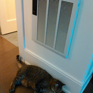

Picture of the QMark heater, with a cat for scale.
