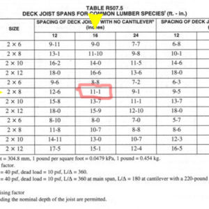

But a quick look at the tables tells us without a bearing wall in the center your 2x8 16” apart are limited to 11 foot 1 inch of span.
It is a wild guess but my bet is the 2 rooms below are each 12 foot wide.

Given this 29’ span of 16”oc 2x8 joists, which is almost 3 times the allowable 11’1” span for living space Walt pointed out, it seems clear that serious additional framing would be necessary to turn that space into living space.
