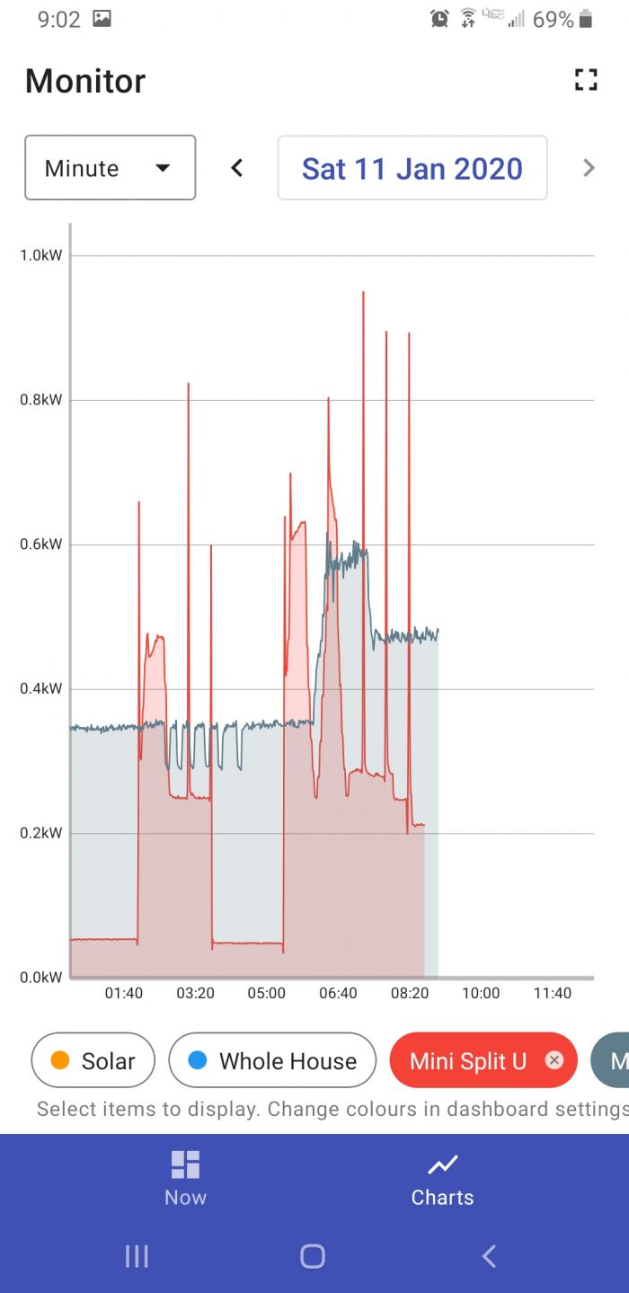

Saw on another post Akos mentioned you can calculate a rough COP number on your mini split with the below forumula. I know many people on here have electricity monitors on their splits and with just a thermometer and the fan cfm off your submittal sheet its pretty easy. I have been recording my return and supply temperatures on both my units as well as electricity consumption.
Its currently 50 degrees here and my unit is running at a COP of 8.

I attached screenshots of my live data.

Its unusually mild here in New England today and it looks like my 12k Gree Sapphire was running close to a COP of almost 10 for awhile this morning. I didnt realize they could get that high. Most of the published data seems to be for when they are running at max capacity.
