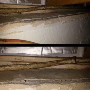

There appears to be some sort of mortar along the top of the foundation wall. It tapers down from about 1/2 way up the sill plate to the interior edge of the wall. I'm not sure what its purpose is (in case you can't tell, I'm a homeowner doing this for the first time), and it's actually separating from the wall in a number of places. See attached image. The sill plate is, of course, behind the electric cables, and the gap you can see is between the mortar and the top of the wall.
My question is what is best to do about the mortar. I can caulk between it and the sill plate, and between it and the wall, and in all of its cracks. It almost seems easier, however, to knock it out of there and only need to caulk in once place - between the sill plate and the wall. But I don't want to do that if the mortar has some sort of purpose and removing it will be a mistake.

A. That's a judgment call. If it is really loose and it pops off readily, you can remove it. If it is stuck in place, caulk all the cracks.
