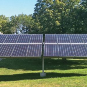

My favorite at this moment example from Home Power Magazine for DIY solar;http://www.homepower.com/articles/solar-electricity/project-profiles/grid-tied-pv-125-watt
Steve,
Yes, that's a nice 6-kW array.
