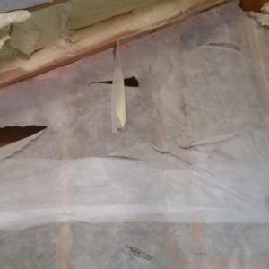

第三级是一个暴风雨的阁楼空间。与前两个级别一样,墙壁是双框(内部和外部2×4帧在10英寸脚板上)。由于我们没有划墙,我们要求绝缘承包商使用啮合到螺柱中的网状物,以保留壁挂在墙壁湾的纤维素。
在前几个月后,纤维素安顿下来,我们重新装满了海湾。在去年,纤维素已经明显沉降,在海湾顶部留下大的间隙。在墙壁的下部,网格是腹部。
Can someone suggest how we can support the mesh, short of sheetrocking all the walls, so that the settling stops, or is at least reduced?

It sounds like you have chosen a contractor who is not experienced in dense packing. The settling you describe would not have happened if the insulation was installed at the proper density.
The fabric shown in the photo was never stapled properly.
准备一个密实充填工作,绝缘bric must be closely stapled, usually to the faces of the studs (that is, the side of the 2x4s that measures 3.5 inches, not the side of the 2x4s that measures 1.5 inch).
如果我是你,我不相信这个绝缘保留者纠正问题。您需要在工作站上获得保温专家,以建议您。

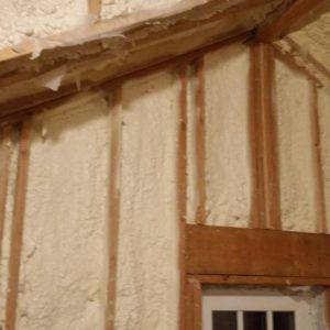

3/16/2016:附加了新照片
我们已经撕掉了纤维素绝缘和网的糟糕。我们用4.5英寸的闭孔喷雾泡沫代替。
It took a day to remove the old cellulose, and half a day to spray the new foam.
这是一个人,我们永远不必担心再次定居。
我发布了上面更新的照片。
