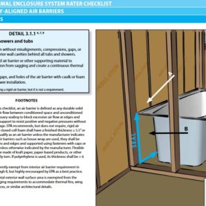

我看了,觉得这是3.1节of this rater's guide for Energy Star homes that we believed that poly barrier had to be installed behind shower wall, as it is on the exterior wall. I recall this being rather clearly stated. Maybe it was verbal communication with raters?https://www.energystar.gov/ia/partners/bldrs_lenders_raters/downloads/Energy_Star_v3_TERC_Guidebook.pdftalks about air barriers behind showers. Please see section 3.1

Lucy,
I think what's happened is that someone on your team has confused air barriers with vapor barriers. Energy Star requires an air barrier at this location -- not a vapor barrier.

Lucy,
I would remove the polyethylene if I were you. Properly detailed, the Dens-Shield will provide an air barrier and a vapor retarder.
The Energy Star program requires both an interior and an exterior air barrier; the main reason for this requirement is to address the deficiencies of fiberglass batt insulation. If you are using an insulation that restricts air movement (for example, spray foam insulation), these additional air barriers are less important (and the Energy Star program will consider the spray foam insulation to be an adequate air barrier).
