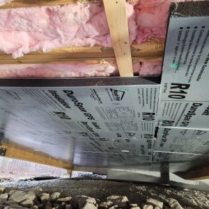

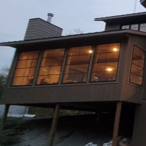

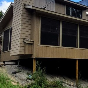

我们现在遇到的问题是,盖有盖的门廊打算是一个3个季节的房间,可以在冬季使用,并能够在冬季加热。因此,它是2×6 16oC,带有R24围兜和R10 GPS护套。R70在天花板上吹,R21 CC喷雾泡沫地板,然后在托梁之间进行R21板,然后R10 GPS板盖托梁,然后是soffet。地板在2英尺至10英尺处的2侧开放,因为地面倾斜到我们的后院。它在浮动侧的螺丝桩上,主侧的ICF粉底墙。
2个外墙中的大多数是大防晒屏幕窗户,所以一个薄的聚窗。非常漏水。无r值。房间里有一个良好的密封木燃烧壁炉,带风扇和一个小型电加热器。

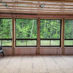

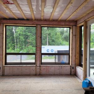

So here is the issue. We are using it more then expected in the winter. When we warm up the room frm minus 15C it takes 5 hrs with a fire. Then when it cools, water is condensing above the ceiling vapour barrier. We have water puddles above the ceiling vapour barrier. They turn to ice until was warm it up again. We want to change out the windows to triple pane casments so we can still open up the screen room in the warmer months. Then warm the room permanently to maybe 10 or 15C and warm it up a bit more when we use it.

NOTE: The area in the pic that looks like batts in the ceiling is under our bedroom. Behind those r20 batts is 4 or 5inches of CC sprayfoam. That’s why there is no vapour barrier in the spot.

蒸气屏障密封很好。我们将要查看它以确保,但是据我所知,没有针孔可以泄漏到房间组件中。
