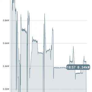

Here is a snapshot of yesterday's data that includes many defrost cycles in the morning to give you an idea on what you would see.
Interesting. I don't think I'm reading that chart right though. Mind helping me out quick as I'm new to energy monitoring. I read that chart as:
1) On average you're using about .5 kW per minute (roughtly), so about 30 kW per hour
2) At .217 kWh per kWh, means that it's costing on average $6.51 per hour to run
But that seems too high, so I think I have a misunderstanding on how it works.
Thank you again! And will checkout the energy monitoring. I originally looked into Sense, but it doesn't work well with variable loads so will need to look at a circuit breaker based one. Also thanks on the fan speed tip. Assumed the opposite, so good to know!
Its per hour. At full capacity it will draw around 1-1.2 kwh hour. You can see in the graph it briefly ramps up to max capacity when it first starts but then settles down to match the heat load. Total consumption that day was 8 kwh so around $1.60 for the day at New England electricity prices. Though my solar panels produced significantly more than that. Heating oil is around 2.69 a gallon here so the savings are quite clear.
Thanks! I was just researching and realized my misunderstanding. Think I get it now. Really helpful!

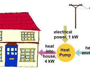

Here is a pretty good explanation of a ASHP.
An Air Source Heat Pump (ASHP) will typically produce around 4kW thermal energy for every 1kW of electrical energy consumed, giving an effective “efficiency” of 400%. It is thermodynamically impossible to have an efficiency of more than 100%, as this implies that more energy is being produced than is being put in. For this reason the performance is expressed as a Coefficient of Performance (COP) rather than an efficiency. The above example would be expressed as having a COP of 4. The reason that it appears that more energy is being produced than is consumed, is because the only “valuable” energy input is electricity used to drive the compressor and circulating pumps. The remainder of the energy simply transferred from a heat source that would otherwise not be used (such as the ambient air, ground or a river) so is not considered as an energy input.

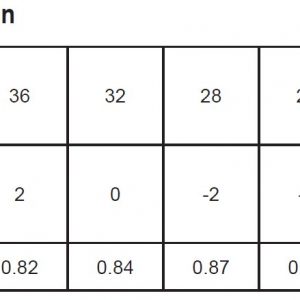

dnicekid:"Also my split often starts in defrost mode when it’s over 32 degrees is that normal?"
These are the defrost adjustment factors for the Mitsubishi M-series heat pumps. The biggest hit appears to fall between -2°C and +4°C.
