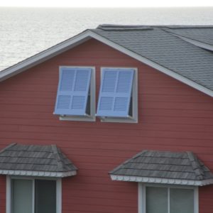

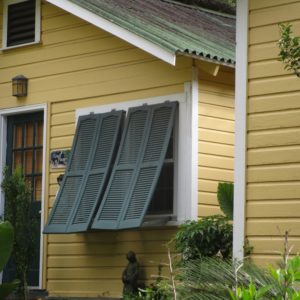

Simple awning-style shutters are probably cheaper than motorized exterior blinds.
I meant to mention, we have casement windows. Aside from that, with those style of shutters you're not ever going to see much out of the window.
