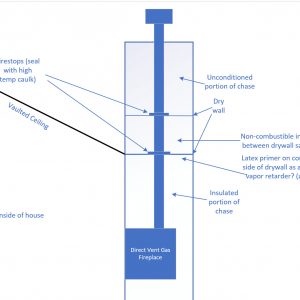

我正在用燃气壁炉代替制造的燃木壁炉。这意味着我可以从房屋内部到外墙上的框架追逐。
我想在Firestop上定义追逐的热/蒸气边界,并希望正确获取细节。是否建议用两层干墙之间的多层矿物羊毛隔离?烟道管将穿过安装在干墙的每一部分上的金属发射机,以保持间隙至可燃。由于矿物质羊毛不可燃烧,因此可以与烟道直接接触。我将在两个开火机上使用高温填缝剂来阻止空气泄漏。我应该将一层乳胶底漆涂在干墙的内部部分作为蒸气屏障吗?我在密苏里州圣路易斯(4A区)。

追逐大约是16英尺高的上到底部。相邻房间的天花板为8',这就是我定义热/蒸气屏障的地方。在这一点上,我将安装一块干墙,切成中心,以允许插入金属燃烧器。Firestop基本上是一块平方的钣金,切开了一个孔,以使烟道管穿过。我建议我将Firestop附加到以减少蒸气迁移的石膏板绘制,因为塑料或Polyiso蒸气屏障似乎是一个可怕的想法。我进一步提出了另一件石膏板,第二次火墙在第一架15英寸左右的位置,有效地将隔热板夹在了干墙的两个部分之间。我的想法是,我需要最大程度地减少隔热层的空气移动,以获得最佳的R从长远来看,价值并防止绝缘材料充满污垢,认为这可能也会影响性能。这是否有意义,还是有更好的方法?

我很难想象您想把火es的追逐中放在哪里。我们可能需要草图或照片。多个打火机是可以接受的。实际上,每当管道通过追逐中的地板或天花板穿过时,都会需要它们。追逐是否在外墙侧有石膏板或胶合板,还是合并了螺柱舱?
我安装一个直接发泄壁炉,所以它使用direct vent pipe, not b-vent. I understand these to be different things. It's an 8" pipe with a 5" pipe inside. The outer pipe is cool intake air. The fireplace store simply told me 1" to combustibles. You could be right that I should keep 1" clearance even to non-combustible insulation. That's still much better than what I had prior which had the old fireplace sitting outside the thermal barrier.
追逐为2x4,从地板到Firestop,我在海湾上添加了矿物质羊毛,在螺柱上涂了Polyiso,然后在Polyiso上涂干墙。在FIRESTOP上方只是空的2x4湾。
Hopefully the sketch helps shed some light.

Your double fire stop seems good. I would line the upper one with the roof sheathing.
I assume the interior wall of the chase is insulated in addition to the outside. You basically have two insulation layers, which is good as these units sink a lot of heat out if the exterior of the chase is not insulated.
The interior painted wall should be a sufficient vapor barrier. There won’t be a lot of out to in vapor drive here.

For the fire block location, put the first one lined up with the drywall, second one at the sheathing to line up with the cathedral ceiling insulation. In between install a piece of duct 2” larger than you pipe to enforce clearance and stuff the rest of the cavity with rockwool.

与油漆相反,您应该认真考虑将金属切成薄片,以适合干墙上的火站,然后用高温填缝到整个聚会上。对于消防街区,第一个与石膏板同意,第二个在护套上,以同意教堂的屋顶保护。
