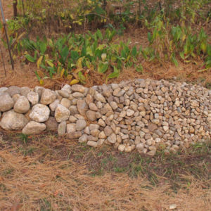

My favorite sentence from your account: "I spent some amount of time sorting my rocks in a truly OCD fashion, into a nice size-graded pile..."

Just like that pile of rocks sitting out in the weather will be
fine on its own, I expect the Roxul [also rocks!] will as well
