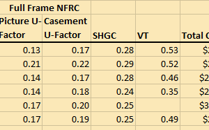

I'm in MN currently building an apartment building and was looking for cost effective fiberglass windows with a sub 0.18 u-value. I got quotes from Kolbe (Wisconsin), Duxton (Canada), Inline (Canada), Zola (East Coast), Alpen (Colorado), and EnerLux (Nebraska).
EnerLux came in as the highest performance I could get within my budget. Kolbe couldn't hit the spec I had. I think all of them make great windows. I can't speak to EnerLux's performance in the field, but the level of data available on their website made me feel comfortable in the decision.
Very interesting I feel like our weather is similar I also had looked into duxton. Would you mind letting me know your thought process other then hitting a spec was price a big deal or customer support long term warranty. Just curious because I have been leery about Canadian companies due to lack of support in the US. Also price comparison on different co packed and support are my biggest concern really.
I made my decision on price, spec and time to delivery. Attached is my price and spec comparison data.
My builder was also worried about not having a local rep to demo installation details in the field and inspect. Inline has a detailed install manual and offered to do a video con to walk through the details for the installers. In the end, I decided the team I have in place (along with my neurotic micromanaging of details I'm learning here on GBA) is strong enough to make sure we get the window details right with remote support.
I can't speak to warranties, but I presume all the ones listed meet the market standard. My intuition is that any brand with decent market share targeting the high performance segment invests heavily in manufacturing quality control and quickly addressing defective windows that make it into the field. They wouldn't last long in the segment if they didn't.
I didn't want to spend a bunch of $$ on high performance glazing and put it into a vinyl window that will get leaky and need to be replaced in 10-15 years. That meant fiberglass and going further afield to brands that unfortunately don't have much physical footprint / support in MN.
I'd rather have a great window with a thin warranty/customer support that I never use, than an average window with great local support that I have to use regularly.
