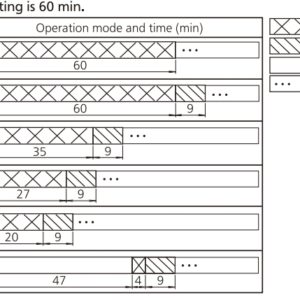

One more thing regarding the Panasonic and cold temperatures, it does work at -25C, it just switches from ventilation to recirculation as you state. I still see the efficiency rating at -25C as being relevant as this is how efficient the unit is while exchanging air. In recirculation mode it's not putting heat energy outside the home.
Here's the cold weather operating chart from the Panasonic's manual:

Trevor, the -25°C test integrates a minimum number of defrost cycles and occurs over a 60h period. That's why the efficiency numbers are so much lower when it gets very cold. The defrost cycles detract from the efficiency. It's a very useful number to know. Like any laboratory test, it doesn't reflect real world conditions exactly but it still gives you a good idea of how it will perform.

Even at -20, I would be concerned about that duty cycle. If you're already operating at near the limit of the ventilator, and you drop down to 75% duty cycle for an extended period (days), that's a problem.
If you have a big gathering, your ventilation needs go up, not down, so any reduction in that scenario is undesirable. I think you'd have to crack some windows in remote parts of the house.
Four minutes an hour is basically zero, and I suspect the main purpose of those four minutes is to periodically sample the outside air to check if it should change modes.

Agreed, 4 min an hour is pretty much just checking when it's safe to start ventilation again. So far this year that would be the case for about 10-15 hours in Ottawa, if there was no pre-conditioning of the air.
