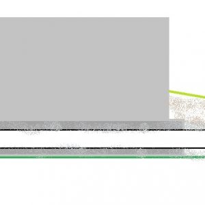

Hi. I am ready to make my house pad and I am not sure of any benefit to hauling in several loads of material when I can just cut out of the existing slope and have the same pad and drainage without the added cost of several loads of material.
Attached picture is to help understand my question as I do not know the proper terminology.

The more common approach to your "cut-out" house pad is the "cut and fill approach." Ih this approach, you don't have to bring material in or out. You cut material from the uphill side, and fill the downhill side with the removed material. This is often the most cost-efficient approach, but it requires careful placement and compaction of the downhill material so that it doesn't move after the house is built. There are pros and cons of each method.
The fill-only approach raises the house pad above the local grade level. This is good for water management, as any ground water will remain below the pad, and in flood-prone areas, it can raise the pad above likely local flooding. Even ponding water in the soils around a house can cause long-term moisture damage to walls and other infrastructure, and a raised pad can be a good thing. Also, the fill brought in can be selected (must be selected) for good mechanical properties. The downside, as you already know, is that bringing in fill is expensive.
An all-cut approach as you describe is also a possibility, usually if there is a use for the excavated material elsewhere on the site. If you have deep layers of organic topsoil, removing it is often beneficial, and the topsoil has value in itself. There is obviously potential for cost savings of not bringing in fill. It requires good quality subsoils that are suitable for placing the pad. It also requires more attention to water management, as now the pad is below the natural grade level. If the home is going to be slab-on-grade, you now have the base of the walls below grade level, and you will have to modify the wall design to deal with the moisture, and potentially, with soil loading. If the house is going to have a basement, the all-cut approach is somewhat common, as it allows for a walk-out entrance on the downhill side, and the masonry foundation can still extend above grade level on the uphill side.
Cut & Fill is, of course, somewhere in between the two above approaches. The decision on which method to use is generally based on the style of foundation, the site conditions (slope, water, soil), and other design factors. Any of these approaches can work.
I highly recommend having a water management plan before you make your decision on this. I went with the "cut" approach and pushed the soil downslope to level out the yard a bit. The house sits in the hill and seemed like a better option than having the downslope side be VERY tall otherwise. The problem, as mentioned above, is that I'm now I am into some pretty wet ground in the winter and have had to manage it. Nothing a little drainage plan cannot fix but I may have don't things a little different had I known the amount of water I'd be seeing in the winter months.
