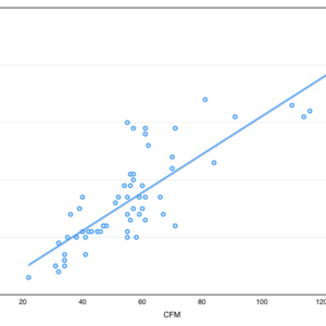

  9. John Semmelhack||#9
    Most room pressurization/depressurization recommendations for undercuts and transfer grilles are theoretical and do not factor in airflow around door jambs and head (we've found a typical gap of 1/16" to 1/8" for pre-hung doors) nor other smaller, unintentional airflow pathways (via interior walls). We've done a good bit of real world testing of room pressurization and feel confident room pressure difference will remain under 3Pa with supply airflows to bedrooms as high as 75cfm when the door undercut is at least 1/2". See attached graph showing test results of over 60 bedrooms (3 different builders), with just door undercuts (no transfer grilles, jumper ducts or return ducts). Undercuts varied from 3/8" to 3/4", flooring was about 50/50 carpet vs. hardwood.
  10. GBA Editor
    Martin Holladay||#10
    John,
    基于测量的答案,而不是数学!太好了 - 各个方面都优越。
