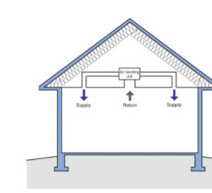

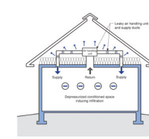

Putting the HVAC ducts and equipment in an unconditioned space like attics and crawl spaces is a bad idea if you are paying for the fuel, but it great idea if you are selling the house. Because no one wants to pay for a utility room, make the same space a bathroom and 10k to in your pocket.
If it is too late to put the equipment inside the thermal boundary the only real solution move the thermal boundary from the ceiling to the roof.
Please take the time to read this article
https://buildingscience.com/documents/published-articles/pa-are-you-doing-somethig-stupid/view

John,
If the system uses combustion to create heat, it has to have an air source. Sealed combustion is better than atmospheric combustion. But Walt is right, the best solution would be to move the system and ducts inside the conditioned space.
