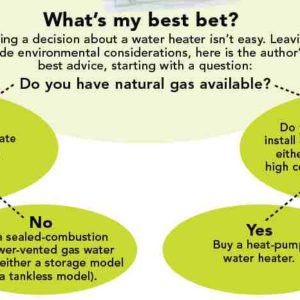

    Rick,
    这是一篇文章的链接,该文章为房主提供指导,做出像您这样的决定:The Water Heater Payoff.
    The article includes a decision tree (reproduced below).
