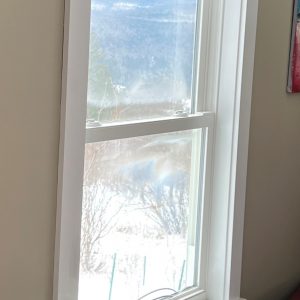

Several of our windows have had the seals fail, they turned four years old this month, otherwise they have functioned well. Still waiting to hear from customer service. Post on this forum if you any advice re: customer service if you can.
That looks like a defective IGU. Inline uses Cardinal IGUs, or at least they did a year or two ago when I last spoke with people there. You might want to see if this is a warranty issue.

User-685535, I don't have any suggestions. My windows look the same with the fogging and getting a good bit of frost on the inside of the outer pane with the winter temps. They don't have the pieces bowing up like that though. Windows are 3.5 years old now based on install date.
