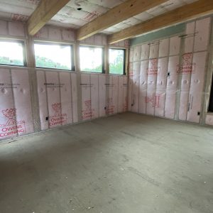

我们仍在建造新的建筑。我们安装了内联Windows。到目前为止,我很开心。
Prior to ordering I drove to Toronto to see the product first hand and got a tour of the factory (no local showroom or distributor). They use cardinal glass and we spec’ed triple glazed windows. We have mostly fixed windows that have a nice low profile frame (no sash). We chose tilt/turn mechanisms for the operable windows- the sash is pretty wide on these. We chose regular sliders for the patio doors.
We haven’t lived with them yet, but so far I’m happy.
I’m happy to answer other questions.
Alan

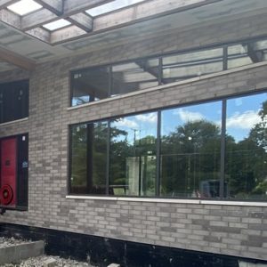

我们在俄亥俄州的中部我们被动房子里加入轮廓,遮阳篷和固定窗户。
我们的早期研究将我们带到了多伦多设施,在那里我们了解到所有加拿大玻璃纤维窗口公司都有内联制造框架材料。
We dealt with them directly, and picked them up in TO. All of the paperwork was in order for the border crossing.
窗户已经完美地表现(但南方窗户目前覆盖着冻雨)。我们没有玻璃纤维刮擦或涂料刮擦的问题。
