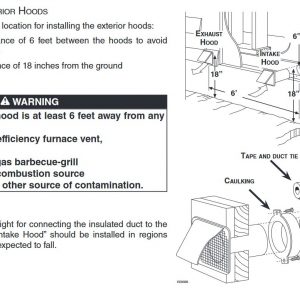

Have you contacted Broan-Nutone to see whether the company sells exterior hoods? The image below is from their installation manual.
