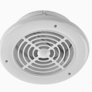

我在Lowes找到了一个具有整体阻尼器的拱腹通风口的选择:https://www.lowes.com/pd/IMPERIAL-8-5-in-L-White-Plastic-Soffit-Vent/3126431
这让我在4英寸Panasonic EZ通风口和Lowes发现的帝国之间选择了两种弊端的较小者。当厨房排气处启动时,它会降低到更好的通风,或者在厨房时停止空气泄漏的情况稍微更好通风关闭。

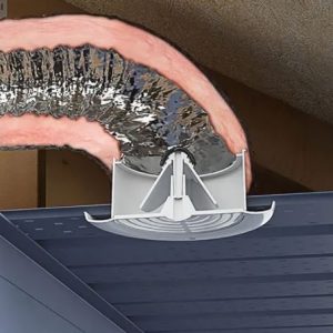

Bought the Imperial product at Lowe's. It is better than I expected it to be, but could be better than it is...
It includes a horizontal butterfly damper that relies upon a spring which may loose tension over time, and sag. The reviews also indicate the spring rusts out. I will probably try to replace it with a stainless steel spring, and have an extra one on hand in case the original sags.
The 6" neck of the device where the butterfly flaps open is not as deep as the flaps, so the flaps do not fully open. They could have made the neck about 1/8- 1/4" longer which would have let the flaps open a full 90 degrees.
当关闭蝴蝶阻尼器时,脖子上的水平法兰与阻尼器襟翼的周长之间存在微小的缝隙,每个襟翼两侧的铰链。但是,法兰是放入一些稀薄氯丁橡胶的好地方,这应该在关闭时使这件事更加紧密。
有一些标签从脖子的外围伸出来,显然是要在脖子上创建孔并“捕获”柔性管道。我宁愿将管道滑到脖子上,并用蠕虫夹和胶带将其固定。认为这些标签只会撕裂管道,所以我正在考虑将它们切断。
塑料是轻巧且脆弱的 - 绝对比我在其他区域安装的Panasonic EZ通风口低的塑料。
However, for $13 and immediate availability this device is a cut above the rest and gives a nice secondary damper for a 6" soffit vent.

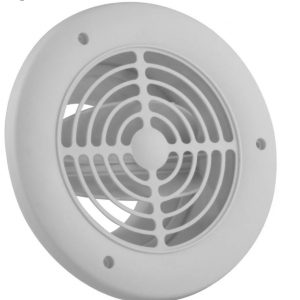

Installed the Imperial product, but now I see that on the Lowe's website, Imperial finally gave an accurate response to the Net Free area of their 6" vent as 5.29 square inches.
The smallest portion of the Panasonic EZ vent is through the +/- 3.5" flapper, which would have an area of about 9.621 square inches.
So does the 4" Panasonic actually have more free area and thus greater airflow / less restriction than the 6" Imperial product?
Something seems fishy. If the net free area is 5.29 sqare inches, and one divides that by pi, then that would translate to a roughly 1 3/4" diameter hole. I wonder if the information they gave is off...
我毫不怀疑它们可能是错误的,因为他们最初发布了自由区为.3047平方米,但5.29似乎是可行的。
Their claimed net free area of 5.29 = Pi (1.3) squared. If the radius is 1.3, the diameter is 2.6. So they claim to have a free area equal to a 2.6" hole with absolutely no blockage.
一个6英寸的圆形圆形开口的面积为28.26平方英寸。这件事并非没有打扰
- First, before air gets through the damper, the damper hinge obstructs a good portion of the opening all the way across. Lets call it 1" wide x 6" = 6" si
- Second, before the air gets to the grill, the damper flappers obstruct part of the grill opening. In the photo from their website they show the flappers only partially open and a gap, making you think it could open more. But the edge of the flapper furthest from the hinged ends hits the grill, stopping the flapper from fully opening. They could have made the neck 1/4" longer to solve for this, but they did not. So that obstructs some air. The second photo posted here is with the thing as far open as it will go.
- 第三,烤架的脸至少为1/3塑料,这也阻碍了空气。
松下不公布th的免费净面积eir 4" EZ Vent, but I think it may be more than this 6" vent....
