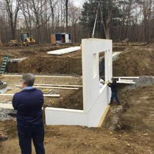

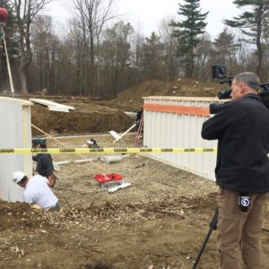

Check out Composite panel systems out of eagle river, wisconsin. I was about to the pull the trigger on superior walls when I found them. My wife and I decided to use them instead, I felt they were 'superior' to superior walls and with all the concrete problems having to do with high PYRRHOTITE content in the aggregate plaguing our area (NE connecticut) we were looking for a concrete alternative. Stellar company and great people to deal with, no concrete other than footings and our foundation was set in a few hours with a light duty crane (after I DIY'd the concrete footings), its made entirely from foam and fiberglass. Inherent Vapor barrier due to the fiberglass. I have been super happy with the decision thus far. Also decent R-value over a typical concrete wall, and fast. Its worth looking at in my opinion. Can't wait to move in and really test it out. I also put 4" of foam under the slab.
