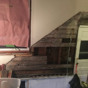

我们生活在一个家庭是建立在1920附近Chicago, IL. Our plot is narrow and the front portion of the home is the original house, with a very large addition on the back from the previous owners (2007). The staircase in the old house was sloping heavily to the right. We had a structural engineer come take a look and he attributed it to natural settling and didn’t see any signs of continuing movement and didn’t make any recommendations aside from sistering one joist. I’m not a master carpenter, but I have built a staircase or two in my life. We have another staircase to access the upstairs so I decided to take on the project of tearing out and rebuilding the stairs. After removing the stair case and landing, I’ve discovered a number of problems. The previous homeowners did some rehabbing on the old part of the home, but all the work they did was pretty shoddy. Above the stair stringers, they removed the plaster from the lath and installed sheetrock. Belong the stair stringers, which is the headroom for the stairs to the unfinished basement, the plaster was left alone and paneled over (although I think the panels were there prior to the previous residents). I removed the panels to find the plaster in very poor condition. It came off in large chunks and was unsalvageable. I removed the rest of it and I also found that some of the lath was dry rotted or split. I removed some of those sections and found something VERY strange, in my opinion. I found wallpaper of different patterns attached to the studs, with the patterns facing into the cavity. The whole wall seems to be wallpapered this way beneath the lath from what I can see. Is this some kind of vintage attempt at a vapor barrier? After removing the crumbling paper, I found what was left of some cellulose insulation that has all accumulated at the bottom. However, I’m not interested in removing the sheetrock that’s already been installed over the existing lath. I also see that the house still has it’s original cladding, but the previous homeowners put hardieboard cement siding on top of it. I’m not sure how this affects the needs for vapor/moisture barriers. The wall that would need to be insulated is huge, roughly two and a half stories.

I only have this photo for the time being:

I'm not going to have the opportunity to have someone install cellulose until probably the spring. After looking again, I think I'm better off removing all the lath I can. It's not in good condition, most of the nails are popped, and it's not level or plumb, so installing drywall on top will be a challenge. I'm wondering if I could nail in some 2x4 pieces horizontally at the points where the lath underneath the drywall will meet the area that I'd like to open up. Once I do that, could I install some fiberglass batts in those cavities and then drywall over (probably sistering the studs and pushing those 2x4s out slightly to accommodate for the additional lath width at the top)? This would at least allow me to insulate around that exterior basement door and part of the window. Or would this be a bad idea if I'm planning cellulose later? Thanks again for your help.

Your plan to insulate the stud bays that are accessible from the interior will work fine. As you suggested, you'll need some horizontal blocking between the studs to separate the areas that will be insulated with fiberglass batts from the areas that will be insulated with cellulose.
