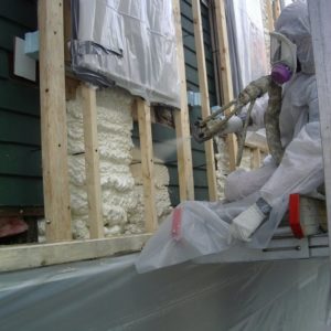

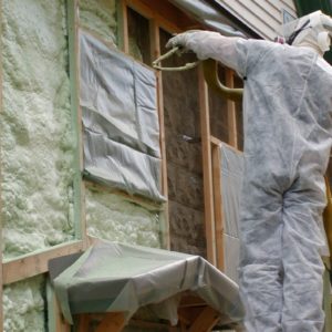

The curtain wall retrofit would include placing 2X4’s vertically against the clapboard siding spaced 24″ on center; then filling the 3.5″ cavities with spray foam or cotton batts, followed by installing two layers of 2″ polyiso rigid foam panels over. Finally, replace the vinyl siding over the rigid foam.

I'm not sure what you mean by "more plausible." Your suggested method is doable, but it won't be cheap -- especially if you use spray foam.
If you want to read more about two retrofit jobs that took the approach you are suggesting, you can read about them here:
Brand New Appearance and Performance for An Older Duplex
Deep Energy Makeover: One Step At A Time
