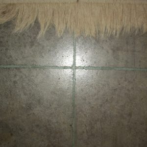

The main floor of my house is cut up into 3 ft squares. The concrete isn't stained but the green grout seems to lend it some colour. This is it after 25 years. No cracks anywhere. No rebar, mesh or fibre either.
That grout makes it look like a tile floor. Do you know if you’ve had any cracks in the control joints hidden by the grout? A slab with no cracks is good luck. Maybe count all those tiles and use those as your lucky lottery ticket numbers :-)
Bill
