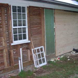

    Hi, I have an 1840 cape. We used closed cell urethane in the walls and roof area. We stripped all the clapboards, trim and sheathing to add the urethane from the exterior. We then put back all the old material, but replaced the siding with spruce clapboards and stainless nails. The roof is a cold roof system with a 3/4" air gap from soffet to gable vent. Recently we added 2-4" of closed cell urethane to the floors. Our wood use has dropped from 7 to 2 cords. The house is fairly small at 1300 sq ft.

    Here's a photo of what I did in the main part of the house. I used two layers of urethane foam with foil facing, leaving a gap to fill with canned foam. The one drawback with this is our cell phones don't work as well inside this part of the house.
