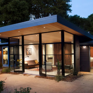

If you decide to design your house with a flat roof, you probably won't be installing tile or metal -- you'll be installing some type of membrane.
So-called flat roofs (also called low-slope roofs) can have a roof overhang if you want. See the photo below.

Flat roof is very unlikely, but thanks for the photo. That would look horrible for the shape and size of my planned house. It will be a simple gable after all.
