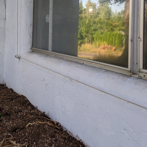

Thank you. It could be synthetic stucco? Is there a way that I could tell?
Correct, I do not have framed walls inside my home
Based on the cracks that have been repaired (by previous owner) and small hairline cracks that are visible now– I don't believe that we have rigid foam underneath the "stucco" on the exterior walls.
Attached a pic of the exterior wall for reference. Interior walls look exactly the same.

Any idea if there is insulation beneath the exterior "plaster?"
I'm thinking it is probably plaster... I attached a pic in my reply to Steve. LMK if that helps or if there is a better angle I could snap to provide more detail.
