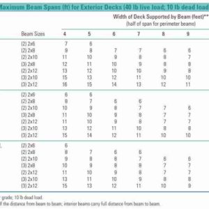

What you call a "rim joist" is actually a beam. You are spanning 4'6" from post to post with a 2x8.
Malcolm, am I being too conservative to suggest that you need doubled 2x8s for this beam?
Martin, Doesn't his plan show a doubled 2"x8" rim joist (acting as a beam)? The tributary area picked up is under 3'-6". In addition, the shed is going to be sheathed in OSB, making the walls to some extent act as box beams. On the tables you posted doubled 2"x8"s will do the whole length of the shed without needing the centre supports.
Malcolm,
I stand corrected. His description didn't make it clear that the beams are made of double 2x8s -- but the sketch does. You're right -- everything is fine.
