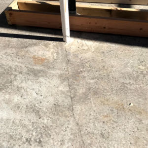

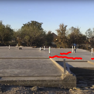

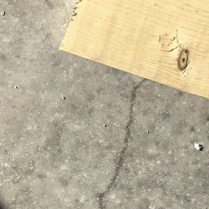

2) Strange lines on the foundation. Looks like small cracks. I can’t even insert a sheet of paper
图片2.png,3.pngand video: https://youtu.be/olsIkgl0SUc

2. There are two kinds of concrete. Cracked and gonna crack.

I like your phrase about a concrete. :) I understand that technically I'll have guaranty for 10 years from the builder. Also I understand that it's common issue and cracks like "spider net" can be after concrete compression. In the internet I found that peoples more concerned when they have vertical cracks (I don't have) and long cracks near communications(I have and you can see on picture 7.png). Unfortunately, it's not clear to me where the line is between a problem and a problem-free crack.
What is most important isn't whether or not there ARE cracks, but both WHERE they are and most importantly: ARE THEY GROWING?
WHERE they are is important that cracks in a structural location that could compromise the structure are a problem. In a simple basement slab, this isn't an issue.
ARE THEY GROWING is what we call "are the cracks PROPOGATING?" In a basement slab, settling could be a potential issue if things weren't properly compacted prior to the pour. What I do on projects where I suspect crack propogation is to put some marks across (perpindicular to) the cracks in a few places, and making sure one of the marks is at the end of the crack. I'll come back periodically to check those marks. If the crack is now past the last mark, I know it's growing. If the other marks no longer line up with each other, then I know the two sides of the crack are sliding. That's what you need to watch for. A crack that stays in one spot and doesn't grow usually isn't a problem in a simple slab. A crack that gets longer and opens wider indicates a problem that needs to be corrected.

About where: I added pictures to show where they are.

It's completely new slab and I just signed my contract previous week. That time I didn't see any cracks. I was really happy that closed my contract with that previous terrible builder. New builder is much better :)
This weekend I came to see whats changed and lumbers that came(my pain from the previous builder) and found these cracks. I assume, that they finished post-tension for this slab 2-3 days ago. After a few weeks I will know are they're growing or not.
BTW I see that other slabs in this lane also got them, so it's typicality.
