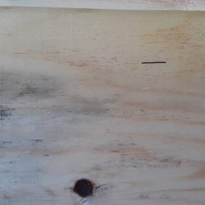

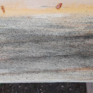

I’ve started framing my new house a week ago. Purchased all materials from a single supplier. Some of the dimensional lumber has quite a bit of mold on it and to my surprise a factory wrapped stack of plywood sheathing has what appears to be moldy patches as well. The plywood was dry throughout the stack, and moldy patches are only noticable on one side of each sheet which makes me believe that it got that mold at the factory and not during storage. Is this something I should be concerned about?
Are you sure it’s mold and not just staining? I’ve seen grayish stains on new lumber before.
Bill
On dimensional lumber it looks like mold, but I am not 100% sure about plywood. Why would mold grow on one side of it, but not on the other that is in contact with it while it is still stacked? I've attached a few pictures
A water and bleach combination in a garden sprayer will take that right off. I am running into the same issue this year with all the excessive rain. There are many products that you can buy at the box stores but the bleach and water combo is by far the best.

As far as the stains on the plywood that I have go, I wander if those are caused by beetle killed wood used in the production of that plywood. I've sanded the surface a bit to make sure that it's not paint or dirt and it looks like it is not, the staining goes dipper into the wood.
Ah. Mold does seem to like more heavily processed wood. Maybe a bleach-etched surface is easier for the mold to grow on. I have no idea.

Thanks for the info Bill. Beetle killed trees is something that I've heard about in the past, but never new all the details. Apparently these little bugs are carriers of a fungus that spreads into the wood and gives it the bluish stain appearance. I don't know how deep into the wood the fungus can penetrate, but it is killed during the plywood manufacturing process, so there is no harm structurally and it won't start growing again. I am still waiting for the final word from the plywood manufacturer on whether it's mold or something else.

Be interesting if you could measure the moisture content of your plywood and framing. Mold growth typically gets a hold at about 19% moisture content. But mold growth is a surface phenomenon; it's all about the water activity right at the surface.
To get rid of the mold, you ultimately need to get rid of the moisture. To get rid of the mold growth you can see, it's just like cleaning any surface: mild soap solution and then let it dry. Trying to kill the mold growth rather than just cleaning it off is a real uphill battle; if the surface remains wet the mold will likely grow back even with a mild bleach.

I don't have a moisture meter, but I'll see if I can borrow one. I doubt though that the moisture content is an issue at this point, since these patches appear only on one side of the plywood sheets, but not on the other, even though the non "moldy" sides were in direct contact with the "moldy" ones.

Mold needs stagnant air, moisture and darkness to thrive. Eliminate one variable and it won't grow. Ie the moisture will be gone once it moves from the lumber yard to your house
The stains on the plywood look similar to Blue Stain to me.https://www.southernpine.com/using-southern-pine/blue-stain-faqs/
FAQ是SYP木材,但我认为类似的咒骂ects happen with certain infections in other softwoods as well. Like everyone else says, clean the surface, dry the wood, and don't worry too much about it. For extra insurance, go ahead and spray everything affected with borate to suppress any future growth.
Peter,
Thank you for the link. As they suggested in the FAQ for SYP I've tried to sand it off, and it does go dipper into the plywood layer. At this point I am pretty sure it's not mold, but I'll spray it with boracare when I'll be treating bottom 2' before installing insulation.
