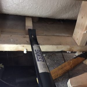

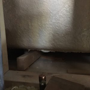

I wanted to give you an update on the progress in the hopes it may help others and to ask a few additional follow up questions/advice.
My contractor removed the first row of tiles and realized the plumber hadn't screwed in the integral tub flange into the wall but instead but the screw 'on top of' the flange, which was rubbing against the tub. He fixed that issue. This was also a slight creaking near the front left side of the tub. He cut a thin piece of the wall away and the sound stopped. He is going to caulk it.
The contractor's plan for the bottom of the tub is to put 2 2x4s underneath near the legs for additional support. He is nervous about the spray foam (even though multiple people have recommended it to him) because he used a bit of the non structural stuff during an earlier fix, and the tub was rubbing against it, making additional noise. I said that as long as he uses two-part foam and fills the whole cavity, it should work. However, he wants to try the 2X4s. We aren't going to secure it but leave it for a few days to check.
What are your thoughts on this 2X 4 'solution'? I want to make sure that the 2X4s won't cause additional issues, like cracks down the road if the tub keeps 'hitting' the 2X4s when I step into it.
I've attached a few photos (badly taken, sorry) to show the 2x4s.
Also for some context, I live in a walk up condo in an old building, so I picked an acrylic tub because I thought it would be easier for my contractor to carry and install. I now wish I had just ordered a cast iron and had him deal with getting it up the stairs. Lesson learned.
