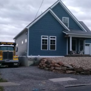

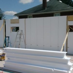

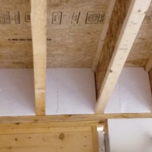

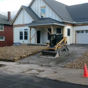

Hey Guy's, Thought I'd give you some input on these builds. I hope the pictures post properly?
After all they do say a thousand words. As a builder I like this system better than all the others we have utilized or contemplated, and Here is why.
