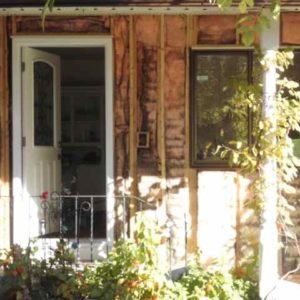

Here's a picture

That doesn't look to me like old stucco behind the 2x4s, but I'll take your word for it.

Those are the fiberglass batts, they are filthy because the vinyl put over them, attached to the studs, and lots of dirt and dust was blown in over the years. Would spray foam be the best option? Could I put rigid foam in between the studs attached to the house?
