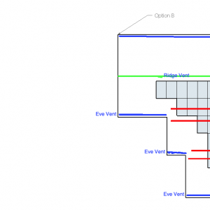

我有最后一个问题,如果您可以看一下通风口的计划,让我知道您的想法。我对有这么多通风口感到紧张,但我不确定除了根本没有发泄外,我还能做其他事情。
在图片中,您将看到太阳能电池板的去向,通风孔以蓝色标记为已经存在的前夕通风口,红色剖面的通风孔和绿色,以及存在的山脊通风口,但将替换为一个新的。
That does feel like a lot of venting. I would calculate the amount free vent area you need for each section and size the vents for that. The upper attic probably does not need a full length intake vent. Most likely the partial eave vent on the south side and eave vent on the north side would be enough free area.
If there isn't a lot of structure between the cathedral roof and attic sections, you might be able to combine the intake and exhaust vent into a single vent by making a couple of vertical cuts into the sheathing.
The lower attic section can also be gable vented, looks like you should have enough space on the siding for an exhaust vent.
