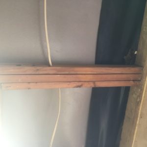

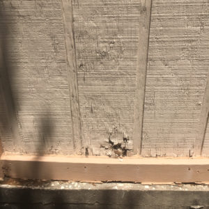

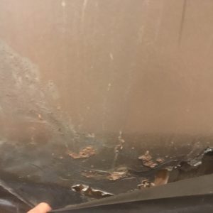

    在某些情况下,有墙壁部分砖和壁板,而热派是唯一的背衬材料。这些地区的壁板处于较差的状态,我认为至少在这些条件下,这可以解释受损的t-ply。[前2张照片]。我们将在今年晚些时候更换壁板和水槽,希望这会照顾很多水分问题。
    坡度在某些区域看起来几英寸太高,但是即使我可以看到完整的粉底板,我仍然看到T-Ply中的孔。哭泣的孔现在看起来还不错,但在某个时候可能会被蚂蚁丘堵塞。有飞溅的问题,导致侧壁腐烂,但在这些区域没有T-ply,毛毡纸看起来状况良好。
    The grade does not appear to be sloping towards the house.

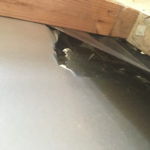

    第三张照片是损坏的t-ply,似乎没有用一些建议来解释,而且我看不到土墩。在我看到污垢丘的地方,我假设受损的t-ply是由于哭泣孔的蚂蚁/堵塞所致。
    If the windows were not properly sealed, could water be collecting at the bottom of these studs and be causing the damage to the t-ply? [fourth photo, hole in both black plastic and t-ply]

    我不愿通过互联网提供建议。需要进行现场访问才能弄清楚为什么要腐烂。
    The usual order of business would be:
    1. Determine the source of the moisture that caused the rot.
    2. Remedy the problem that allowed the moisture to accumulate.
    3. Remove all rotten components and install new materials.
    In general, the ThermoPly should be fastened directly to the exterior side of the studs and bottom plate, so I'm not sure why you are thinking of "wedging it [the XPS] between the undamaged t-ply and the studs."

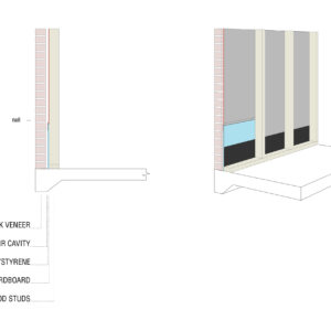

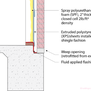

    By wedging it, I meant some kind of adaptation of an approach to a flood-proof wall assembly as proposed by the Building Science Corporation [first attached image]
    https://buildingscience.com/documents/building-science-insights/bsi-101-rebuilding-houston
    where the xps is installed in a shingle-like fashion. There, the foam runs along the complete height of the wall, but in our case, we wanted to know if it would be possible to use the existing t-ply, cut just above the deteriorated portions, and insert the foam just underneath the t-ply, using adhesive or a flashing tape to secure the foam. [second image attached]
    我不想在墙壁上防洪水,但是直到我们能够解决水分问题之前,我希望有一种解决方案可以作为更好的水分屏障或排水平面,而我们可以进入这些区域。如果有帮助,我也可以在底板上使用一些闪烁的胶带(并用填缝/泡沫填充缝/接缝,如最初讨论的那样)。我知道这有点倒退,但是我们的时间表和预算现在有些不同步。

    If you are working from the interior (where you have brick veneer), your options for repairing sheathing rot are more limited, and you may have to try something like the approach suggested by Building Science Corp.
