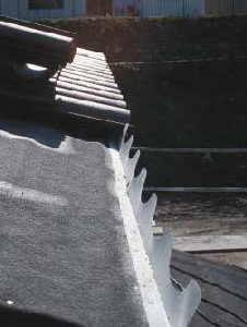

Most tile roofs aren't equipped with soffit vents. Instead, roofers install birdstop metal at the eaves. (See photo below.) The birdstop metal isn't airtight -- lots of air can enter at the eaves.
