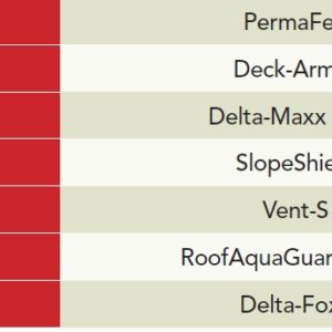

If you prefer a synthetic roofing underlayment, choose from the list below. These are all vapor-permeable. The list comes from my article,Synthetic Roofing Underlayments.
The first column shows the manufacturer; the second column shows the product; the third column shows the vapor permeance. Click the image to enlarge it.
