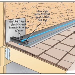

It's possible to vent the roof you describe, if that's what you want to do. The soffit vent should be relatively easy; on the uphill side, the standard solution is theRoof-2-Wall ventmanufactured by Cor-a-Vent. (See the illustration below.)
