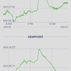

你瞧,我没有实现e this, but the data logger I already have (Sensor Push) has VPD as one of its outputs.
这是一个毕竟是一个简单的计算。许多温室招标更喜欢它,我相信这么多传感器都具有它。
