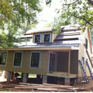

我住在区域3,SC北部。我们建立了exactly the same wall you describe in design #2. My reasons for using Comfortboard exterior to the siding was to reduce thermal bridging, but I also like it's resistance to fire and insects specifically carpenter ants, termites. We live in a very "buggy" area of the country.
We used Roxul Rockboard 80 because I could get it so much easier than special ordering it from the large home improvement stores. That may not be the case for you in Maine.
I don't know which one is the most efficient to build, most cost effective or risky in terms of moisture in the sheathing. I'm sure you will hear from the builders and engineers on this site about those issues. But I can tell you it is a pain to wrap your house in mineral wool. I call it a "cozy mineral wool sweater" and I would do it again, but there are a lot of issues that most builders (in the South anyway) are not familiar with when you do that. We worked through the issues, but it was very time-consuming.
It's still the method I would choose again, but really think through the details first before you do so. Also, calculate how much each method would cost. After looking into sheathing issues, I would always choose plywood since it is able to absorb and release moisture so much better than OSB.
Here's a link to my blog on that exterior mineral wool.http://greenvillegreen.blogspot.com/2013/10/cozy-mineral-wool-sweater-on-house.html
And I have included a different photo on our mineral wool sweater. We decided to use 2" foam around the windows so we could tape to them easier and make sure it is airtight.

Thanks for the information. It appears your design is most like my first design, given that my second design places the wool on the interior side of the house (that may not have been clear in my original post). The pictures and discussion about how best to 'trim' out windows (i.e., foam vs wool) are good to have.
