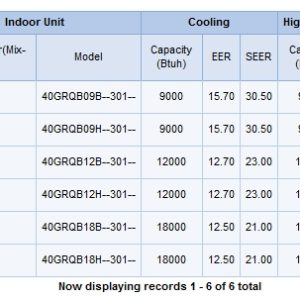

Here is the spreadsheet from AHRI on that model.

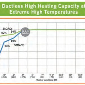

Finding information from Carrier on the 38GRQ model is difficult -- perhaps a GBA reader can find it. I did find the graph reproduced below (froma Carrier brochure), and that graph does indeed seem to claim better performance than shown in the AHRI spreadsheet.

Here is the link to the energy star data for the attachment and it's cousins
https://www.ahridirectory.org/ahridirectory/pages/vsmshp/cee/defaultSearch.aspx

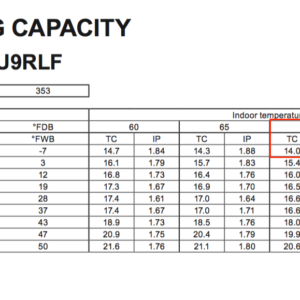

This is a unit I'm considering which shows the strange data 17f "capacity" 13400 BTU while the HSPF is 11 and the manufacturer, in the attachment, claims 19000TU output at 5 f.
Another interesting bit about this pairing of a duct ed indoor and outdoor units is that it gives better HSPF than the same outdoor unit paired with an un-ducted indoors.

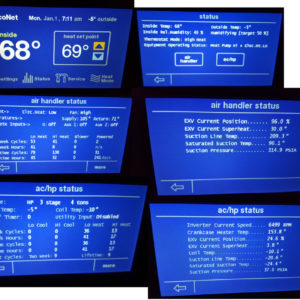

I have been very pleased with my new Rheem RP17. The heat pump does all heating above 10° and most of it below. I think I can set it even lower
At this moment we are in a cold wave, but on average how many hour per year do you spend below 10°

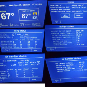

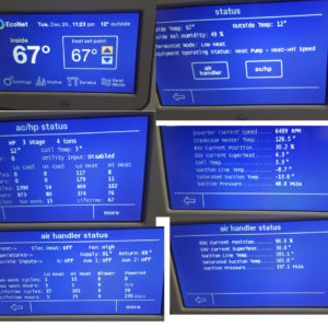

Attached are some screen shots from a cold morning.
Please note I did have a board replaced to get the latest software and lost some historical data.
Walta

THANK YOU! Why? Doesn't testing "performance" at fixed speeds eliminate the influence of the "control system" not only on capacity but efficiency as well? Yes I'll probably use mini ducts but the performance data is all in the same place. Regrettably Fujitsu doesn't offer a single zone mini duct with XLTH (extended low temperature heating) . Mitsubshi and Midea appear to be the only "brands" offering substantial low temperature heating in single zone mini duct.
Jerry -
Fujitsu's AOU/ARU 9 provides 14,000Btu/hr heating at -5F (117% of it's 47F AHRI rated capacity...I'd call that "extended low temperature heating"). Fujitsu does not publish an outside temperature cut-off for these units. I have colleagues who have seen them operating as low as -25F. You state your load is 23,000Btu/hr at 0F. A pair of the AOU/ARU 9k would give you 28,000Btu/hr at -5F. A pair of the 12k units would give you 30,000Btu/hr at -5F.
