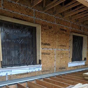

Just installing outie windows in a new build. The question I have is the air and water sealing method, I have my WRB running inside the sides and bevel sill wrapped in stretch tape. The gap is 3/4 on either side of the the window, which have no flange. I have seen either spray foam the whole gap and depth or backer rod with a silcon ( adhesive). I also seen backer rod on the interior and exterior with nothing in between. At the sill I know not to close it off , but should just put a interior seal some how.

In order to keep your sill pan flashing free to drain, you need to airseal the interior of the window unit to something in the rough opening. If you have a back dam as part of your sill flashing, you use a tape to air seal between the backdam and the window unit.

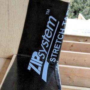

Frankly, you could use the Huber Stretch tape to accomplish this air seal: you apparently already have it and it has a very aggressive and durable acrylic adhesive.

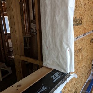

I have to say though, in your third photo, pretty scary looking connection of your sill flashing to your torn WRB...

yeah the picture makes it look bad, I am going to be redoing that one. I have had to install the WRB (tyvek) around the windows before the 6" of exterior insulation.
I don't have back dams, I thought a slope sill was better.
I am trying to get my hands on more Zip tape but its been an issue, I have lots of 3M tape would this work? I may be able to get the ZIP tape.
I assume taping from the window frame to the wood on all sides and not the Tyvek is best.
If you have any other comments, criticisms , suggestions I appreciate them.

For my windows with sloped sill, I had the peel and stick come all the way inside the rough opening. I only had the house wrap come near the rough openings, the rest was all peel and stick.
For sealing, I went with backer rod and caulk on the inside (tape is easier, the 3M stuff seems to work well, super sticky to most surfaces) and spray foam the rest of the bottom. Canned foam is hard to get liquid tight and will drain.

I have been searching online for ideas on how to flash the front of windows and I am not sure I should I should have my Tyvek wrapping all the way inside past the front of the window?
Any opinion on this...

To my knowledge, how far into the window the tyvek goes does not matter. What is important is that it extends underneath any flashing you use.

I'm not a big fan of how you're using the house wrap. I would use 6" zip tape. I would just cut squares of the stretch tape and use it on all the corners, it actually makes it easier to get the corners nice and tight and it saves a lot of money.
