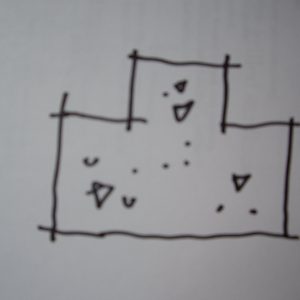

When we pour footing for crawlspaces we also include a short stem-wall on top. This has a number of useful functions.
- It allows you to bury the footing so it isn't visible around the house.
- It provides enough depth for the perimeter drains and rock.
- If the footing is exposed, water that hits the top would move through the p0ny-walls into the crawlspace.
- it protects the pony-walls from the surrounding fill, both inside and out.
The pony-walls can then be insulated using batts, spray foam, or cellulose. Only a short piece of foam board is necessary to cover the concrete stem-wall. This can be placed either inside the crawlspace or on the exterior.
The one disadvantage of having the footings near grade and using wood pony-walls, instead of excavating and using concrete stem walls, is that the first floor of the house ends up several feet above the surrounding yard. That may or may not be desirable.
