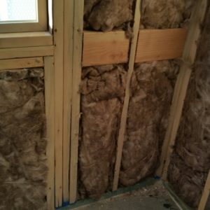

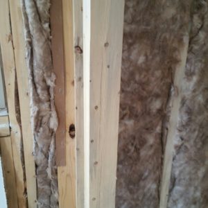

Batt Installation
Geez, they even butchered installing the fiberglass batts into the wall cavities. They ended up crushing and squeezing it in order to get it to fit. In one spot they squeezed it into tiny little ball like shapes and jammed it into the cavity. It's mind boggling.
Click on images to see larger picture.

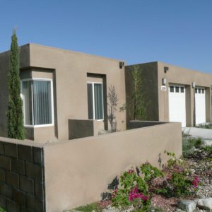

An answer to your question is the mix of tradition and ignorance. Tradition: my ancestor built with wood stick, I will build with wood sticks. Ignorance: in general people is not versed in the big range of construction materials and methods, it is not their fault. We professionals in construction need to show the advantages of other methods besides wood sticks.
我是一个建筑师的几年wi打交道th solving the people needs, as a sample, in the City of Mexico, where earthquakes are frequent, and is there a big need of affordable dwellings, I was requested to build 7,500 houses, very low cost, strong, and comfortable, the time frame was 18 month. The development site was close of a stone quarry, then I figure than masonry concrete pour in formwork will be the solution, then planed to have 25 sets of formwork to deliver 25 houses a day, the system was simple 25 crews of foundation were able to do footings and floor slab, previous waste lines to do such task in one day. The walls with the plumbing and electrical pipes, doors and windows placed on the forming using plywood panels and metal ties, were pour in one day, the next da moved to the foundation done the day before. The walls in place to receive the roof, which I design to use T-beam, the shape of the T was by having CMUs in between stems, the flange required a two inches thickness slab, preformed reinforcement was used, one day for this pour, we use concrete of fast time to reach the psi, required in the structural calcs; it made possible el removed the formwork to the next, to let the finishing people, paint, clean set kitchen and bath fixtures, electrical switches, and outlets, and cleaning the next two days, leaving the sixty day to owners receive the keys and move in.
I beat the time frame finishing the 7,500 in 15 months.
With that past experience I will try to offer to the wood stick people the alternative of have a house resisting natural disasters, a complete safe house, monolithic, and affordable.
I know it is a hard task, but I am confident that looking what concrete pour in place can do, will change the mind of some....
Thank Scott Gibson, you did great!
Some photos of the related above: a group of houses, foundation, walls done roof pouring, the roof T-beams preparation. A desert modern built in Cathedral City, California, the fist concrete house with R56 on walls and roof, saves power.
