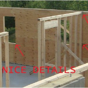

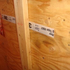

  20. John Brooks.||#23
    卢卡斯,I noticed you have added more stuff...it looks good
    我喜欢你对细节的关注
    您在内部分区之前安装“磁带修补程序”的方式
    and the way the plywood is detailed at the window openings
    I am courious about the plywood seam behind the partition...
    Are you planing to slide tape between the partition stud and the plywood where I show the question mark?...or did you install construction adhesive at the "tongue & V-groove" ?

  22. 卢卡斯Durand - 7a||#25
    哈!
    JB, you are VERY observant!
    You spotted my "secret shame".
    I was careful to install a patch at the top seam as you mentioned but...
    出于某种原因 - 我没有借口 - 我忘了把贴片放在另一个(中壁)缝。
    这就是为什么我在博客上重复自己“确保适当的应用程序......”等。
    你所做的那个非常问号是我了解到,即使建造者正在付出注意,也能学会如何通过裂缝落下的容​​易。
    I ended up "sliding" a piece of tape behind the stud but it involved some prying and creative tape application.

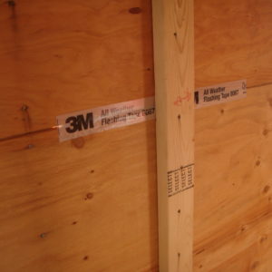

  23. 卢卡斯Durand - 7a||#26
    I will get a picture of how that patch turned out later.
    这是墙壁的同一部分看起来像现在:

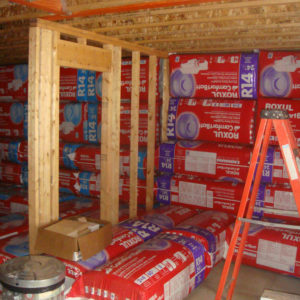

  28. 卢卡斯Durand - 7a||#31
    Now that I have moved the insulation away from the walls...
    以下是您之前注意到的分区墙后面的胶合板缝的一些照片。
