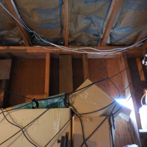

    Well, since I have your attention, here's a trickier one. Our house has a couple of 4x6's that are visible in the crawlspace. They presumably extend from the foundation up to the double top plates of the upper floor. We know that the owner/builder had in mind putting more fenestration in the outside wall upstairs, but decided against it because they chose to put in single glaze windows instead of double - this limited their total window/door area to pass California codes (1984). Could these 4x6's be there as a structural solution to satisfy codes for structural integrity if they decided to put in another sliding glass door? We also discovered a steel member in that wall upstairs, a heavy steel stud. We'd be pleased to put in more windows/doors in the wall but have thought that it takes a very heavy duty steel structure to make that happen.
    Thanks again!
