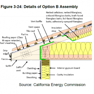

My air ducts are in the attic, and the air handler is in the living space. I asked the local building department if I can convert my attic to an unvented attic and was told that all "concealed spaces" must be vented. Also to keep things simple, I'm thinking that I'll follow Option B in Title 24 (see attached).

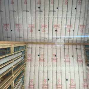

We r in the insulation phase of new construction. We are in climate zone 5 and have (too many) cathedral ceilings and a low pitched roof (1.5/12).
Our roof is not nvented - flash and fill (ccspf and fiberglass bibs) insulation (as described elsewhere on gba - thank you Martin Holladay).
This seamed like a cost effective way to get air sealing without relying on the seal of the surface light to the ceiling.
